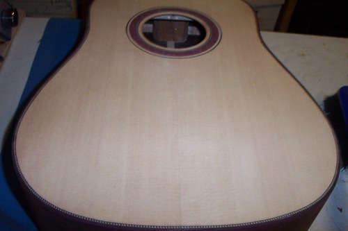

PostPosted: Wed Jul 26, 2006 2:41 pm
Scooter, the purfling is the inner strip that is thinner than the outside binding, think of the Herringbone purfling on a d-28 or a rope purf like on mine!
On the top
And on the back
SergeSerge Poirier38924.9875462963
